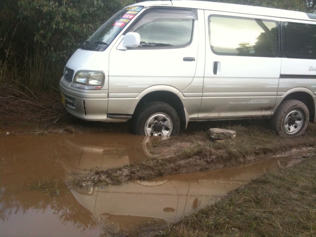

and does this answer your other question Razz :
at least once a week it goes offroad to get to mums place lol

Hahah Laughing Going by the sales stickers on the front window you didn't have it long before getting her muddy.

Yeah straight into the action lol. Wasnt happy about the amount of mud i flung into the newish interior Sad-
G292 here Sad- open diffs all around it seems Sad-
And i discovered the effects of getting bogged with 1 wheel in the air, only that wheel would spin, didnt go anywhere. Just like you said.
