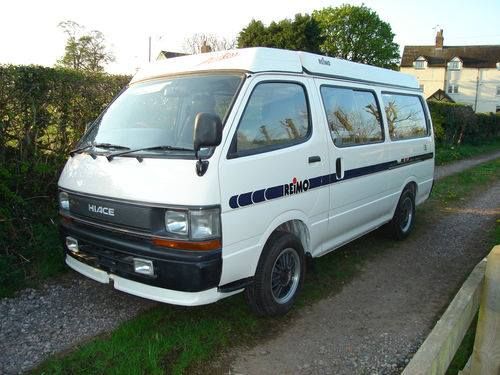

As I've started a couple of threads about my van I thought I should put a few pics up! The van's in great nick body wise, if I can sort it's cooling issues I'll be chuffed.

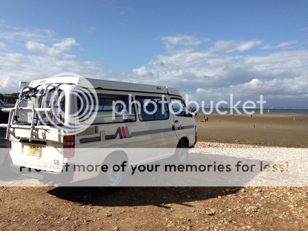

That looks like a lovely clean bus being put to good use, super clean under the arches. Do you have any more interior pics?
Here's one of ours from a recent IOW excursion, I think they like the seaside.
