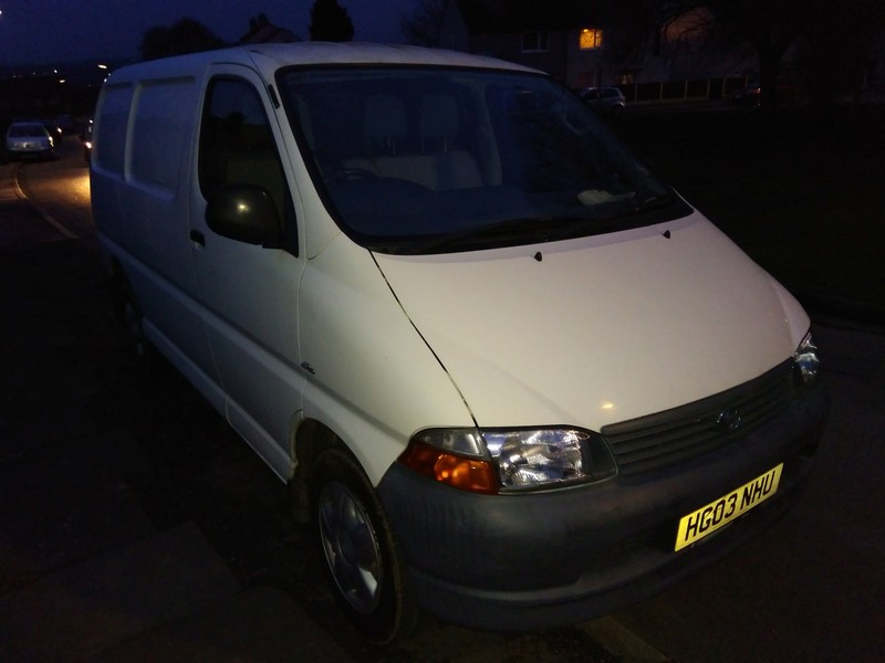

Hi, I've just purchased a Hi-ace van to set up as a window cleaning van. Its in good condition except for the rear tailgate which has had a knock from something and is misshapen and rusty. I'd like to replace it but I'm unsure how to remove it and can't find and manuals online. The bit I'm not sure about is what to do about the electrics that go through the top. Any help appreciated.
