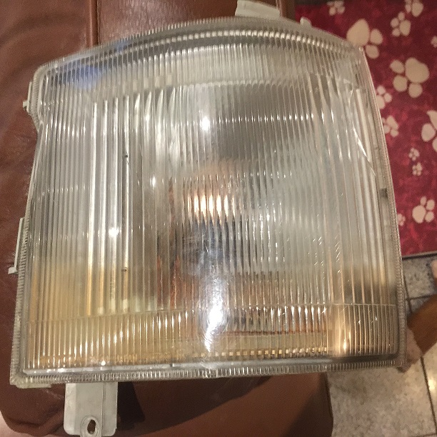

PostSubject: Re: Front grill   Sat Jun 09, 2018 12:52 pm
Hi GPW,
The RH light im after i believe is called a side marker. Its part of the right hand one
Here are some pictures, if your one is the same i would like to buy it, thanks for your help

PostSubject: Re: Front grill   Sat Jun 09, 2018 1:25 pm
Ah I thought you were talking about the headlamps - plus mine is a different style, I think your indicators sit directly under those yes?
Call Paul and order two new ones - I can't imagine they are that much new.
Find out the part numbers first though and have your chassis/vin number handy!
