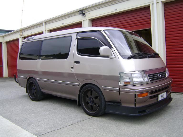

Hey guys,
cheers for the comments. at the mo theyre just sitting round home collecting dust and leaves lol.
I semi did some work on the kit i want to use, so far just the front lip is on. couldnt wait to paint it the same as the van but i really like the satin black so will do the rest of the kit like it lol, kinda looks tough imo.... what you guys think?
by the way, any of you guys know if whiteline make suspension stuff for our vans? was thinking of thicker sway bars but mines apparently got the thickest factory made item being 25mm....

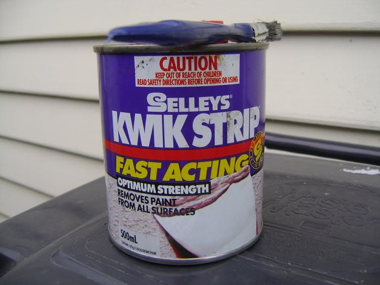

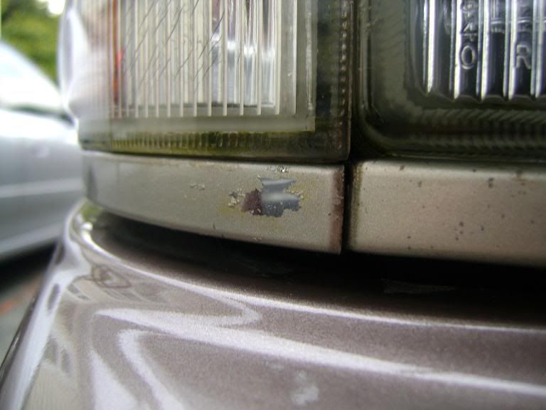

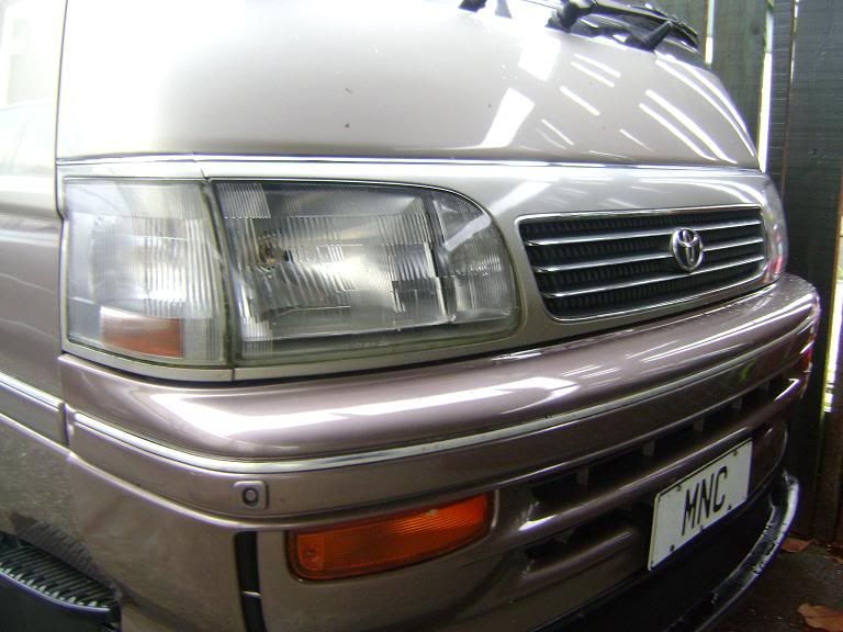

Wanting a chrome grill fror the van for a while and had been looking for one with no luck...after reading on here somewhere that there was chrome underneath the factory item, it got me thinking. SO....this is how i went....

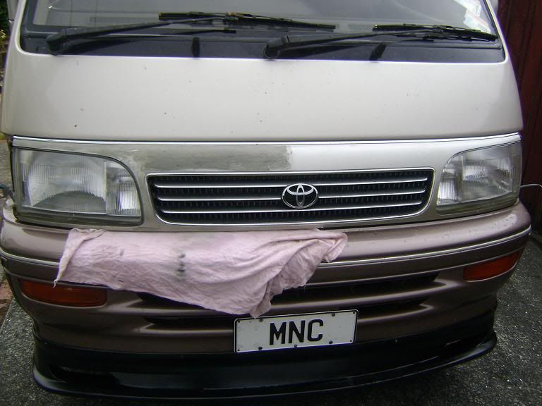

Tested a bit of paint stripper on a little section to confirm this finding......and what ya know....bingo!
Knowing that there was bling under there somewhere, i quickly got to work.....

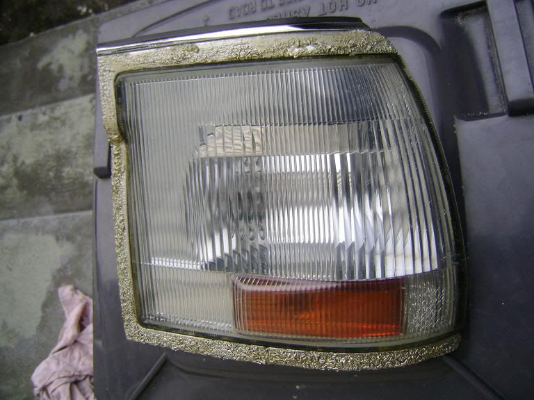

Pulled the corner lamps out and started brushing on the paint stripper.....Please note that the corner lamps are plastic so it pays to either be really carefull when applying the stripper or mask it up.
Leave the stripper on there for a good 5-10 minutes or as instructed till the paint bubbles and lifts from the chrome
When ready to wipe it off, i used hot soapy water (washing detergent) and a good bristled brush.
You wont get it all off in one go so just repeat the process.

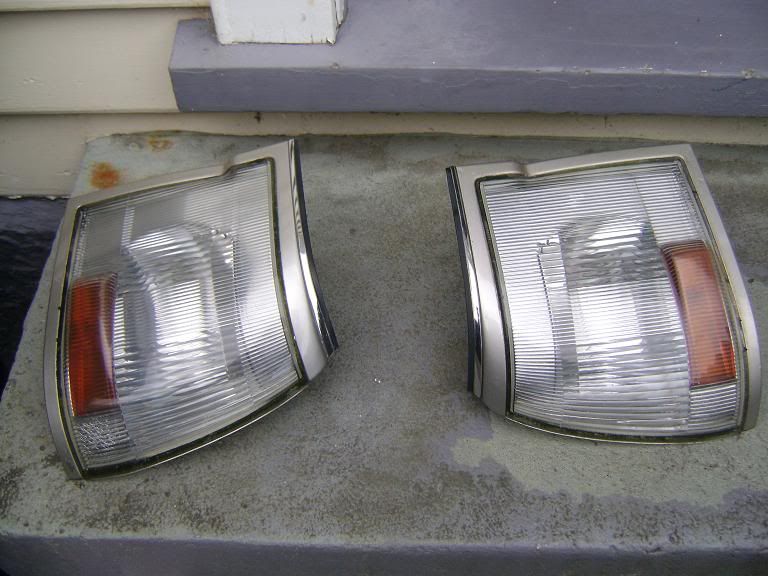

Once you have most of it off, use autosol and a rag to take off any blemishes and shine it up.
Before
After.....BLING! lol
Age : 70
PostSubject: Re: Newbie - MNC - Updated 18/12/2011   Wed Dec 08, 2010 5:46 pm
Damn, big diff hey....well done

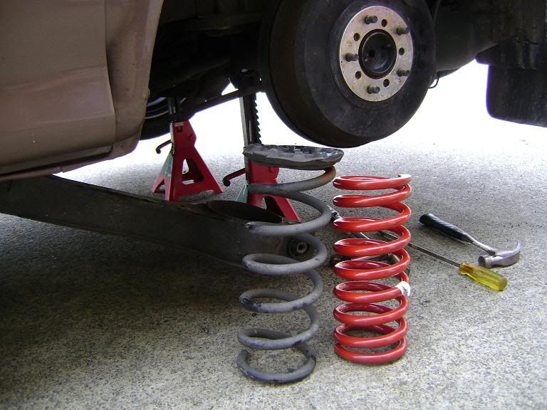

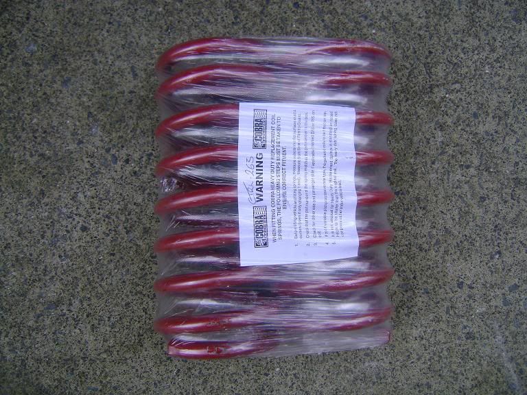

First.... I fitted some Cobra Low springs in the van...pics below.
Cobra low springs

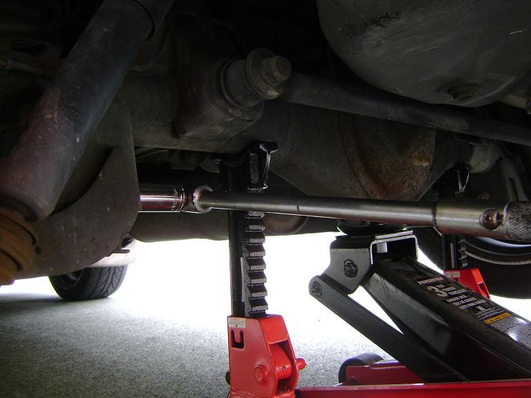

Jack up and place axle stands under the diff - I used 3ton axle stands and a 3ton jackunder the diff head for extra safety and support
Using a 22mm 1/2" tube socket with strong arm, undo the bolt, once lossened i placed the jack under this arm to relieve pressure from the bolt and using a hammer, i used another bolt the same length and tapped it through.
Once the bolt is free, you can drop the arm under using the jack in a controlled manner.
Comparisons of the original spring and the new Cobra Low spring
When putting it back together, make sure the springs are in their locators and assemble in reverse order.
i didnt manage to take pics of the torsions for lowering the front but this was reasonably simple. located just rear of halfway of the van. 2 nuts are holding the torsion bars,1 of which is a locking nut. using a 22mm tube socket, separate the two and completely take off the locking nut. passengers side you will have to take of the stone guard to have better access to the torsion bar. To make things easier, jack up the side you are lowering to relieve pressure off the torsion bar and to ensure you do not strip the bolt. I wound down till there was 10 threads left as a base to work from. once i had sone this, i measured on a flat surface from the ground to the bottom of the guard arch on the rear arch to see how much i needed to lower the rear and compared. Go for a little drive to let the torsions settle and re-measure on a flat surface. Keep doing this and winding till you get the desired height and that your happy with it. It will be alittle more bumpy but hey thats the sacrifice, imo, worth it. Always use the measure method and not go by the threads as this differs.
Tips:
- I have brand new shocks in the front so i was sure that i did not have one soft shock and so on.
- Make sure you have the same psi in tires to get a true measurement.
- Strong arm, tube sockets, Good jack and axle stands are a must.

Remember to have the suspension at the natural height in the vehicle before tightening up the suspension pivot bolts/nuts - otherwise you'll tear the bushes (if tightened up with the axles unsuspended on stands)
MNC
Number of posts : 98
Home City : Wellington, New Zealand
Model and year : 1996 SC LTD 3LDT
Registration date : 2009-09-21
PostSubject: Re: Newbie - MNC - Updated 18/12/2011   Mon Dec 19, 2011 8:05 pm
Cheers man.
Keeping an eye out over the next few weeks and re-measure to see how the settlement goes and re-tighten everything.
dandywarhol
Number of posts : 163
Age : 63
Home City : Edinburgh, Scotland
Model and year : 1995 LH129V 2.8 Superlong semi hi top campervan 4WD with Mitsubishi turbo
Registration date : 2010-01-26
PostSubject: Re: Newbie - MNC - Updated 18/12/2011   Mon Dec 19, 2011 9:03 pm
Don't just retighten - slacken off everything first then retorque - if you tightened them up "hanging" in the first place - otherwise ignore this rambling ol' fool.....................
